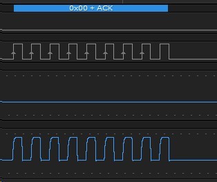

hi,
i am trying to access a remote slave which requires clock stretching using one I2C transaction.
meaning by initiating I2C transaction from Host --> DS90UB9534--> DS90UB953 --> remote slave (clock stretching mechanism activated by remote slave) --> slave of remote slave.
i fail doing this test, i assume that DS90UB953 I2C master doesn't supports clock stretching.
is it correct?
