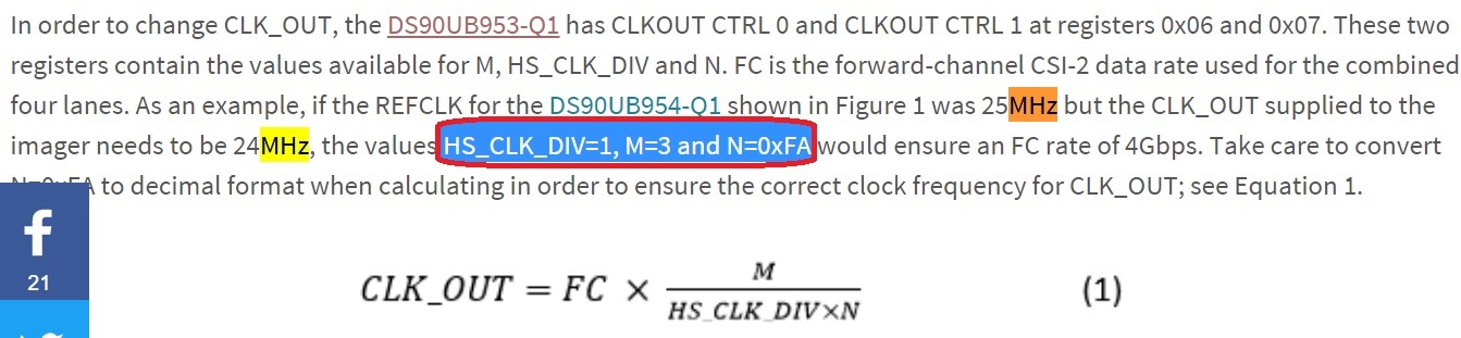

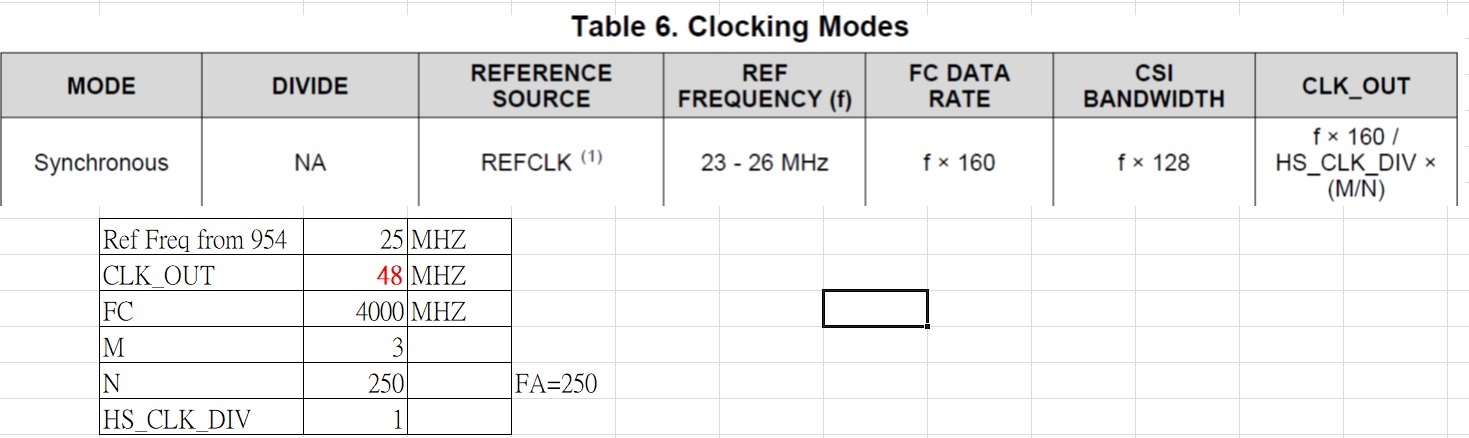

HI Sir
I follow below value to set CLK_OUT of DS90UB953 ,but the result is 48MHZ ,Could you help to double confirm ?

Calculator result
