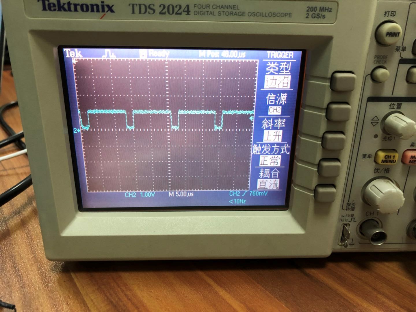

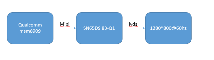

I had use the SN65DSI83 on Qualcomm msm8909 platform(Android5.1), and the SN65DSI83 i2c work normal. I debug the chip on test mode, and the screen was black, the attachment was the LCD datasheet. My DSI CLK is 429MHz, and I divided by 6, the LVDS CLK is 71.5MHz

1. The EN input of SN65DSI83-Q1is pulled high by msm8909 after power-up.
2. SN65DIS83 is i2c configuration, set it to test-pattern mode, the specific settings are as follows:

3. msm8909 DSI driver load, mipi output clock through the oscilloscope as follows:
But screen did not work,I have some question:
1. Is the dis-continuous mipi clock Normal above the picture?
