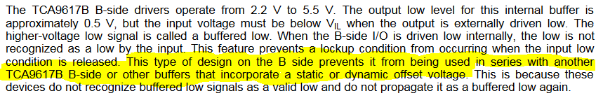

I found the max Vil of TCA9617B is 0.4V in the datasheet? What do 0.3*VCCB / 0.3*VCCA mean?
My customer connect TCA9617B B port output to another TCA9617B device B port as input. B port to B port. But the Vol of B port is 0.54V, what's the max VIL of B port at VCCB=3.3V?
