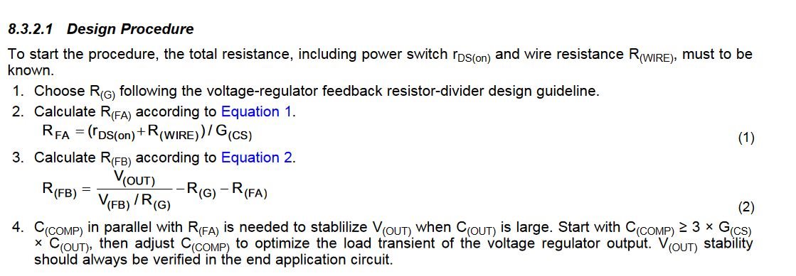

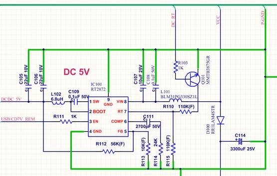

I'd like to seek your advise on how to calculate the C(comp) and R(FA) values?
customer of mine is using RT2872 to connect to TPS2549-Q1
Can I assume the following values are fixed in calculation?
G(cs) = 0.075
R(total) = 0.42ohm
    Please follow below procedure, you can also find it in Page18 of TPS2549-Q1 datasheet.

    I do understand the design guideline in datasheet pg18. but what I do not comprehen are the derivation of rds(on), G(cs) and R(wire)
    Can I assume the following values:
    - rds(on) = 0.42ohm? (is this value get from the upper MOSFET of DCDC or the power switch itself)
    - G(cs) = 0.075?
    - R(wire) = 0? (how does TI calculate this value?)
    Sorry for the inconvenient caused
    Hope you can give me some guideline or help to advise the values based on customer's DCDC

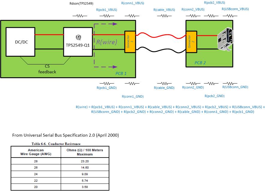

  • EL -
    Hope this helps.
    - rds(on) = on-state resistance of the internal FET (TPS2549-Q1). Refer to Electrical Characteristics table, page 5. Assume 72 mohm as this is the maximum value over the temperature range -40 to 85C - a common operating temperature for this device.
    - G(cs) = 75uA/A. Refer to Electrical Characteristics table, page 6. For every 1A of current flowing to your USB load, the CS pin will sink 75uA from your dc/dc feedback network to ground. This is what adjusts the dc/dc output voltage to compensate for load.
    Cable compensation is used to offset the effect of IR drops from the dc/dc + TPS2549-Q1 to the USB receptacle. The purpose of cable compensation is to maintain ~5V across the USB receptacle under normal USB load conditions.
    Please refer to attached picture.
    - R(wire) = R(wire) is the summation of all resistance drops from the OUT pin back to the GND pin of the TPS2549-Q1. This depends upon completely on your application and implementation.
    Connectors:
    If you are using custom or automotive specific connectors between pcb1 and pbc2, you should consult the manufacturers datasheet for the pin resistance of these connectors.
    Cable:
    It is common for automotive implementations to have 1m or more of interconnect and cabling between the USB VBUS power source and the actual connector (for example Type-A). The USB 2.0 specification provides estimated wire resistances based upon AWG. Again, consult your supplier to obtain a more accurate estimation if needed.
    Hypothetical Example.  Please determine R(wire) for your exact components.
    rdson(tps2549-q1) = 72 mohm
    R(pcb1_VBUS) = R(pcb1_GND) = 2 mohm
    R(conn1_VBUS) = R(conn1_GND) = 20 mohm
    R(cable_VBUS) = R(cable_GND) = 1m 24AWG wire = 2 x 9.09 ohm/100 = 90.9 mohm
    R(pcb2_VBUS) = R(pcb2_GND) = 1 mohm
    R(USBconn_VBUS) = R(USBconn_GND) = 20 mohm
    R(wire) = 2 x (2 + 20 + 90.9 + 1 + 20) = 267.8 mohm
    RFA = (rdson + R(wire)) / G(cs) = (72 mohm + 267.8 mohm) / 75 uA/A = 4530 ohm
    John
