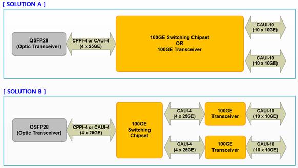

during new development review, we need 100Gbps switching chipset (or transceiver).
if you have a suitable chipset or solution, we will ask you to recommend it.
1. Configuration conditions
: Structure to connect 2 ports CAUI-10 (10 x 10Gbps) to 1 port QSFP28 optical module
: Meet one of the two solutions below
2. Requirements
: 2 ports are input to the backplane side (CAUI-10). If these 2 ports are switched over, no link down should occur.
: The interface of Optic Transceiver side (QSFP28) supports CPPI-4 or CAUI-4 (4 x 25GE)
: Performance is 100% based on 64Byte (If you do not support 100% on 64Byte, please request information reply about maximum performance)
3. Requests
: Switching chipset or transceiver recommended 2-to-1 switching (yellow part chipset in the above figure)
thanks,
