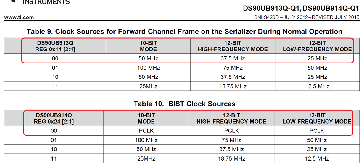

Hi Team,
For DS90UB913A-Q1, the clock sources can be chosen from the table 9 below. The clock sources for 0x14 [2:1] = 00 and 0x14 [2:1] = 10 are shown to have the same frequency. I am wondering what happened. Thanks!
