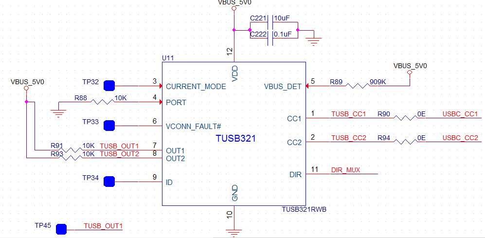

I used this TUSB321 part in UFP and also it be a USB powered design. In TUSB321, OUT1 and OUT 2 open drain pins are used to detect the how much current we can get it from USB Host/DFP device.
we got an output on OUT 1/2 line when we connected to DFP. in this I want to know the delay time between the transition of CC pin attachment to OUT pin outputs in BUS powered applications.
below mentioned the flow of functionality:
USB Connector inserted
CC Pins detected the attachment and current capability
VBUS activated on DFP side
VBUS detected on TUSB321 - that time only TUSB321 is powered on
After that, we will get a output on OUT 1/2 lines
This delay is not mentioned in the datasheet. could you confirm the delay time?
Design attached here
