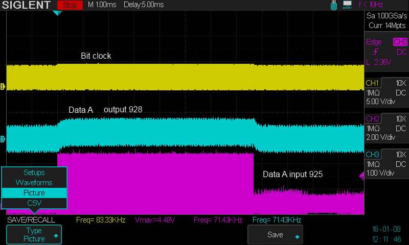

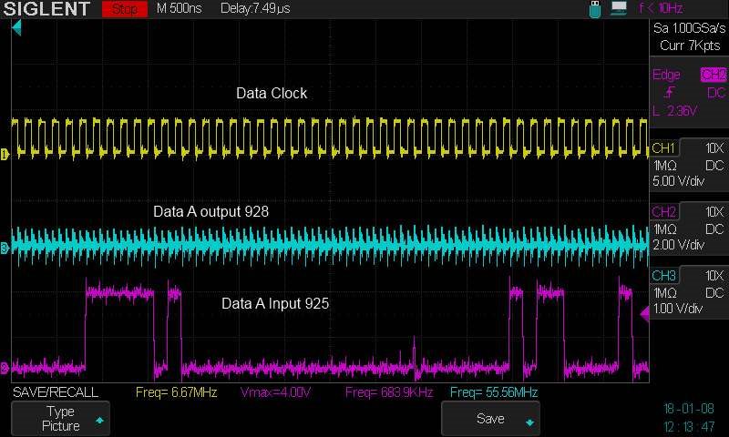

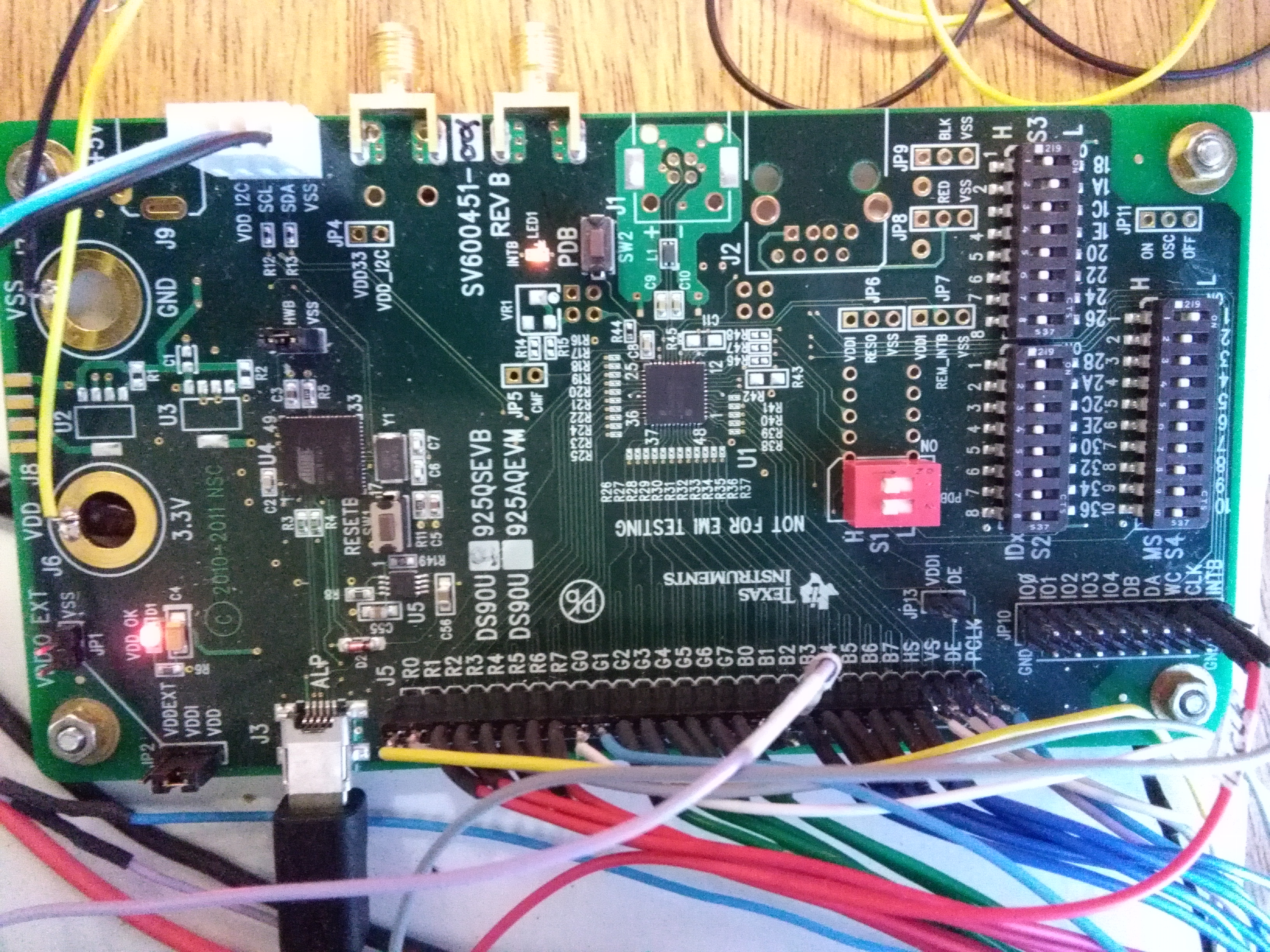

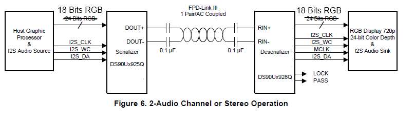

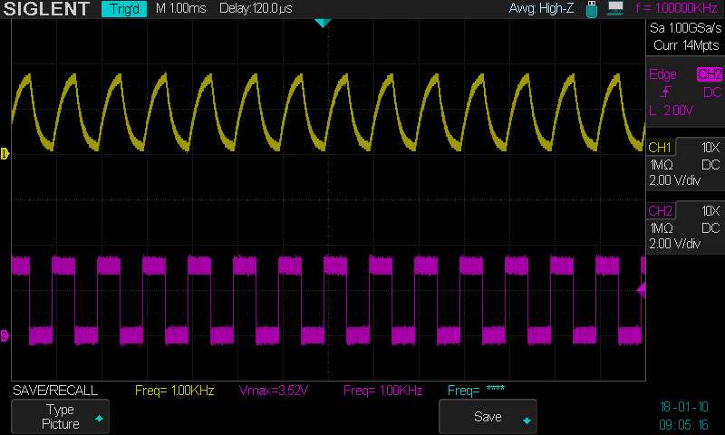

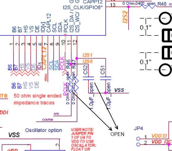

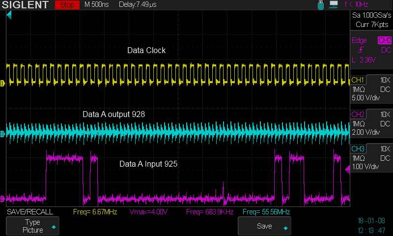

hi, we can't configure evaluations kits in order to send audio over I2S interface; the signals MCLK, I2S_WC, I2S_CLK are working but no data on I2S_DA;
video is 18bit, we want to use only channel A for audio (channel B disable)
data is 16 bits 32kHz sampled (at 8KHz I2S_WC, I2S_CLK doesn't work).
We can`t find the correct register configurations.
