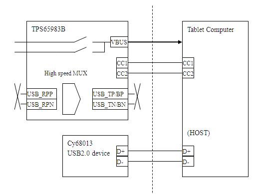

I design a board these days.
It is connected to Tablet computer through type-c.
The board provide power to charging the tablet and communicate with the tablet by USB2.0.
The board does NOT have DisplayPort, that is , it does NOT need alterlate mode fuction.
Tablet is Host. The board is USB device , and has 5V power itself , NOT powered by Tablet.
My questions is:
1. Can I direct connect the D+/D- line from Tablet(HOST) to USB device? Not through the Port Data Multiplexer in TPS65983B.
See the diagram attached.
2.The board's POWER role is SOURCE, and DATA role is UFP.

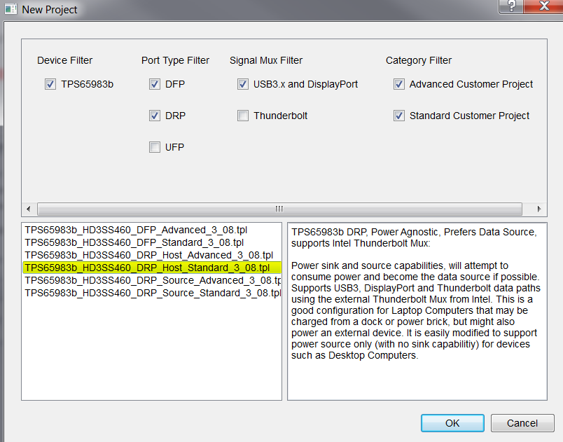

Which template can I use in the configuration tool?
