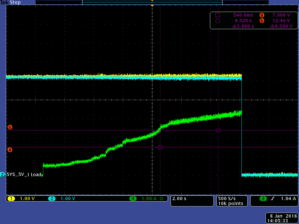

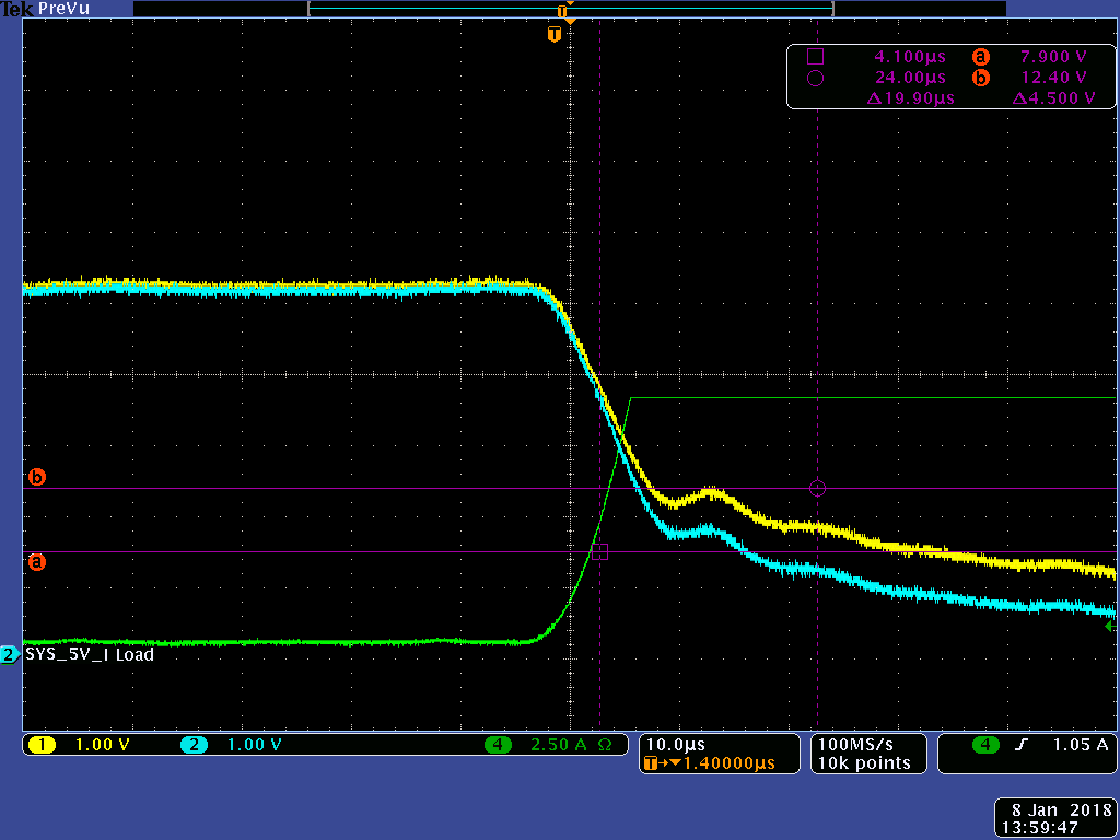

 My system is power sink side. we have use TPS65983
We have try to short power to GND , and Power source will be disable ( 5V --> 0V ).
I want know this protection form Power source(ex : Type C adapter ) or Sink ( My system TPS65983 ) ?
because I have test OCP function. When Load > 3A , Vbus will be disable. File : tek00006
but I use short , current limit will happen on 2.3A , Vusb will be disable. File : tek00004
I don't know this protection is OCP or UVP?
