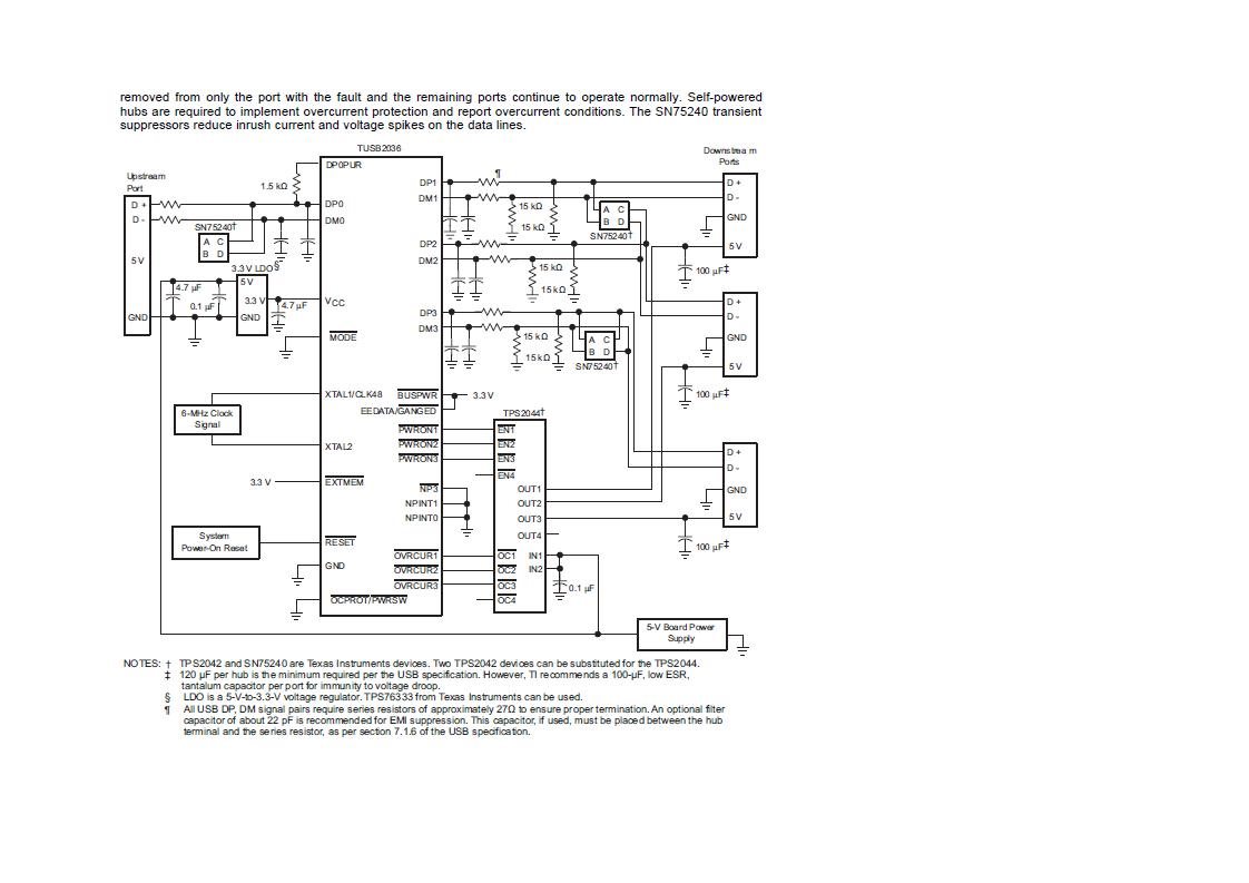

Part Number: TUSB2036
TUSB2036 NOT WOKING SCHEMATIC1 _ nrde_comm_v1_FINAL.pdf

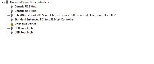

Sir i Rd resistor connected still no working, but i have on doubt that if i connected only one USB downward connected and remaining USB open is it matter
Dear Joel Jimenez0:
Today i will do all necessary connection check" once any correction in my schematic" PDF let me know . i will give you update result on Friday
