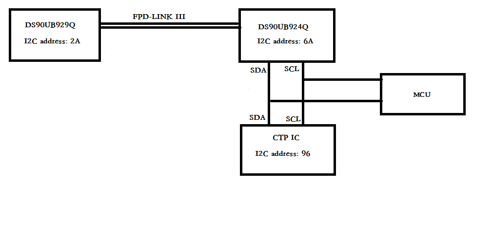

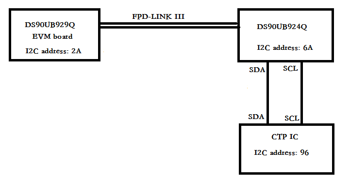

AS it shown in the schematic diagram,

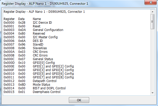

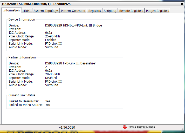

 When i use the PASS-THROUGH function ,i set the I2C address through the Analog LaunchPAD as follows.

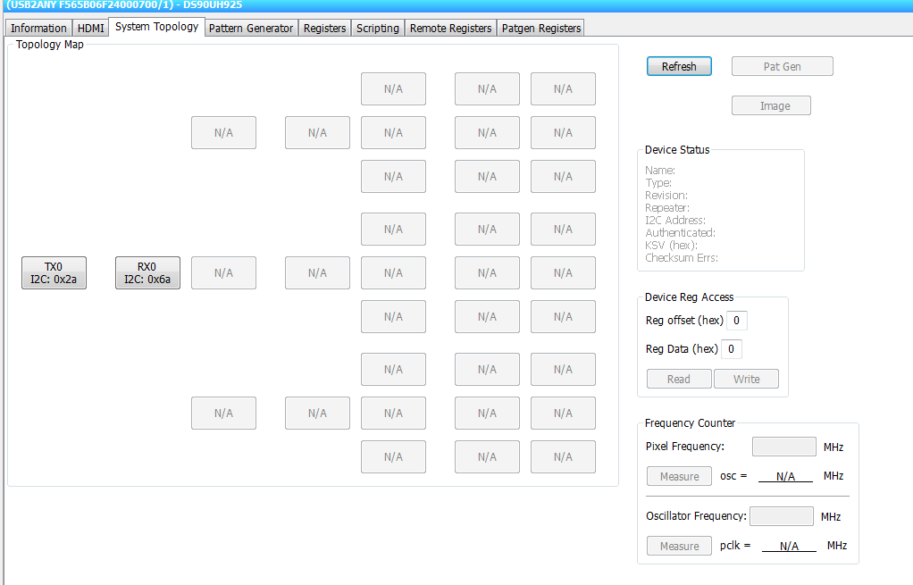

And when i use the system topology function, we can see the deserilizaer can communicate with serilizer,but can't discern the CTP IC,asfollowing picture show.
And when go back to see the resister value ,the 0X0007 and the 0x0008 value changed, i don't know that is why?
1)Why the resister value changed?
