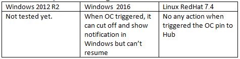

  • Hi Jorge,
    Do you have idea know if this OC behavior is supported by the following OS? ( We are server team and use server OS)
    customer says that their project deson’t work well with some OS
    1. 2012 R2
    2. 2016
    3. Linux Red Hat
    SOC CPU vendor think it’s more possible there is something wrong in OS. Obviously Linux and 2016 behavior is different.
    But SOC vendor don’t have tool to show it. Do you have a tool to check it or it’s known issue in your side?
    SOC vendor will do more on the TUSB8041 HUB. Please provide your comment if you see the similar request before
    thanks,
    SHH
  • Hello Scott,
    The TUSB8041A will automatically turn port power off as long as overcurrent input is held low.  If the USB power switch stops asserting the overcurrent, the hub will re-enable the port power if the host has not already logically turned off the port power.
    • Typically Windows platforms require the hub to be re-enumerated or power cycled before the drivers will re-enable power to the downstream ports.
    • Some Linux builds may not actually configure the interrupt endpoint of the hub that reports overcurrent or they may ignore the bits if they do read them
    Jorge
