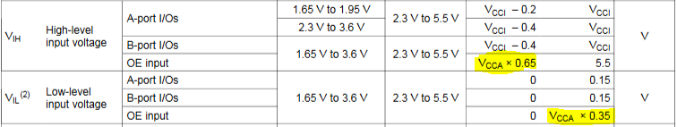

We are using this TCA9406 part in one of our products
In the datasheet it is mentioned that OE must reference to VCCA
Is this because of the Tolerance level of the pin is similar to VCCA ? Why is this recommendation made?

    TCA9406 does not have to be pulled up to VCCA but it should already be referenced to VccA internally through a weak pull up resistor. By doing this externally you will have a better pull up than what is provided.
    "Is this because of the Tolerance level of the pin is similar to VCCA ?"
    -The tolerance of the OE pin allows for 5.5V.
    "Why is this recommendation made?"
    To ensure this reference voltage is high and the pin does not see noise (EMI coupling to the pin and pulling it low) or crosstalk which could pull it low. A stronger pull up will ensure it stays on when it is meant to stay on.
    -Bobby
    EDIT: It was brought to my attention that you may have been referring to this table.
    The device is comparing the voltage of the OE to a ratio of VccA. Where if the OE pin is above 0.65xVccA, the pin is said to be high and the device is enabled. When OE pin falls below 0.35xVccA the device will be disabled and lows will not propagate from A to B or B to A. Thus it is recommended if you intend to enable this device, you should keep OE pin higher than 0.65xVccA which pulling up to the VccA will ensure.
