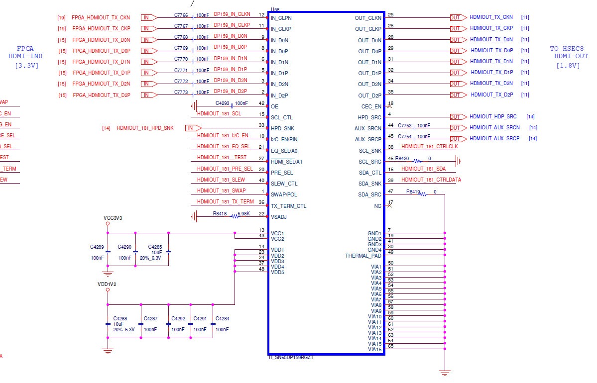

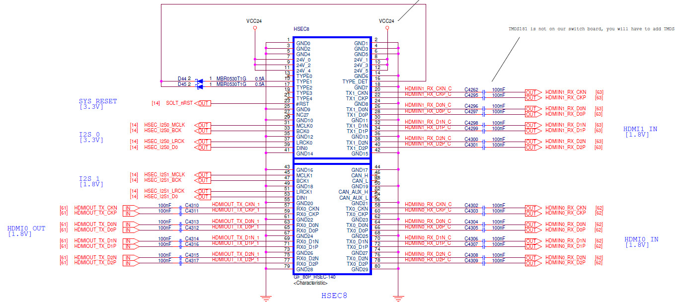

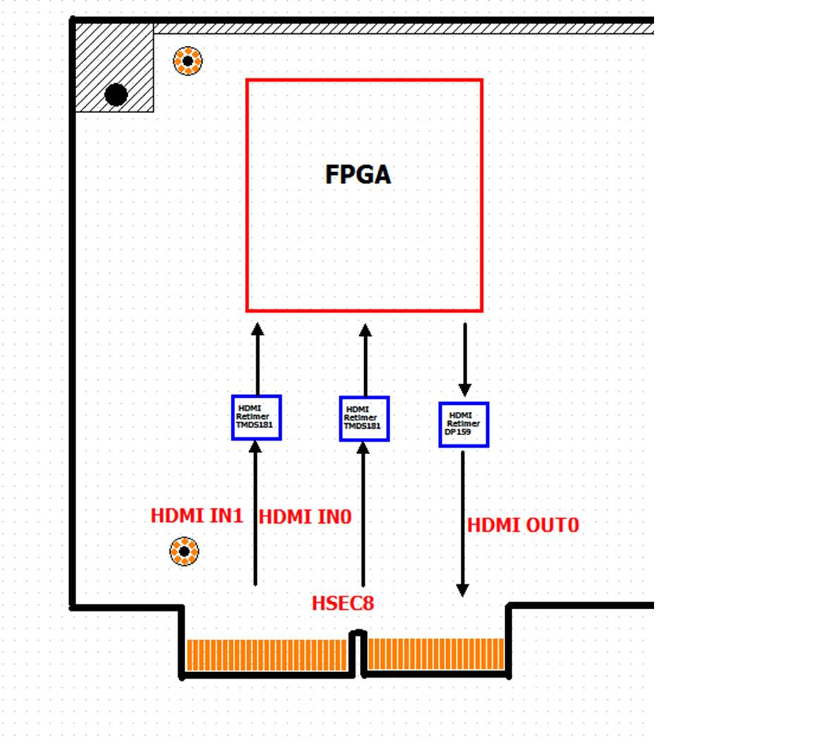

Hello.
I have a question about SN65DP159 and TMDS181 Level. About this design Is there any need to pay attention.
Please kindly help it. Thanks~
Hello AJ
The inputs of the DP159 have to have AC-coupled capacitors, in case of the output depends on electrical characteristics of the sink that you are using.
