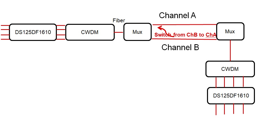

Part Number: DS125DF1610
HI Sir
Our system structure as below
If power is stable ,when I change channel from Channel B to Channel A
How many time that DS125DF1610 can re-link complete ? I can't make sure this is related with CDR

On the DS125DF1610 the max CDR lock acquisition time is 100ms.
