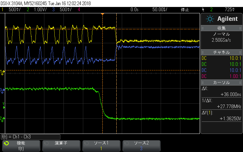

    I want to confirm about environment of measurement.
    In case of "lock asserted", I also confirmed similar result, however, in case of "lose lock", I observed different result.
    (949/948 pair, Green : LOCK, Yellow : CLK0+, Blue D3-)
    Could you please tell me which potion did you measure ?

  • Hello Machida,
    I used 947EVM and 948 EVM with STP cable, and used pattern generator on 947 for input. Set 948 Reg 0x34[7] =0 to configure RX_LOCK asserted only when receiving active video.
    When disable the pattern generator, it will lose lock and CLK would go to zero.
    Cera
  • Hello Cera-san,
    >When disable the pattern generator, it will lose lock.
    I performed same way. Difference is only SER device(I used 949).
    Maybe, something was different, but important thing is "unit" when lock is asserted and lock is lost. So, your result may be fine.

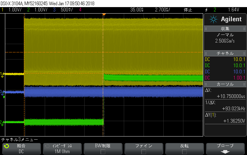

    BTW, I confirmed delay time for DS90UB914A. Then, I got following result.
    (Yellow : PCLK, Green : LOCK Blue : VSYNC)
    This result is strange, because PCLK  is active before LOCK is asserted.
    Could you please confirm about DS90UB914A at first and confirm whether you also got same result or not ?
  • Hello Machida,
    Sorry to reply late. I tested the 914 timing and got the same result. We are now trying to figure out the reason.

  • Hello Machida,
    For 914, the lock signal is generated differently in different mode. It is verified that in 12LF and 10bit mode, PCLK will become active before LOCK output. In 12HF mode, they go active at the same time. We will update the datasheet later.
    Cera
  • Hello Cera-san,
    Thank you for your confirmation !
    Actually, I observed difference b/w "12 bit HF" and "12bit LF, 10bit mode".
    However, in case of 12 bit HF, I can observe approximately 3 us delay as shown below.
    1. Is it not expected result ?
  • Hi Machida San,
    It should be alerted at the same time according to design's simulation. I will double check it.
    Cera
  • Hello Cera-san,
    Do you have any update ?
  • Hi Ryuuichi-san,
    I tested 913/914 at 12bit HF mode, and the result is the same with you, about 3us delay. The design simulation data is not zoomed in, so it looks at the same time.
    Cera
