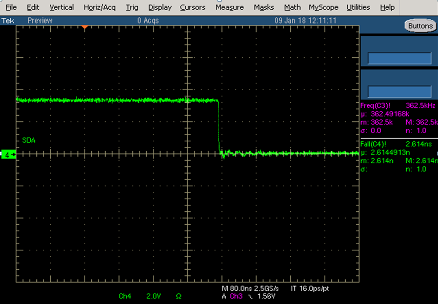

TPS65982 SCL/SDA fall time are over spec.
Is there any concern?
Thank you.
| tf | ||
| SCL | 1.046ns | Fail |
| SDA | 2.614ns | Fail |

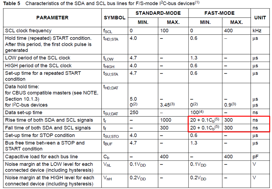

Hi Eric,
In table 5, the rise and fall time are lower than the minimum of spec. They should be at least 20ns.
I am check the value with the customer and will get back to you.
