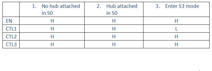

  1. No hub attached
  2. Hub attached
  3. Enter S3 mode
EN
H
H
H
CTL1
H
H
L
CTL2
H
H
H
CTL3
H
H
H

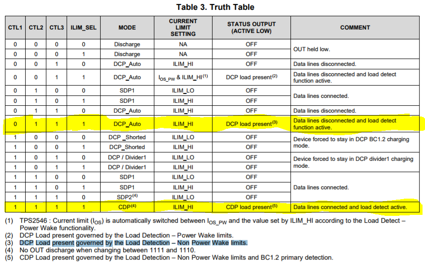

    Please clarify, when the system is S0 the TPS2546 is in CDP mode (1111) and when the system changes to S3 the TPS2546 is in DCP Auto mode (0111)?
    The system automatically resumes to S0 when in S3?
    If you look at the table above, when the TPS2546 is set in DCP Auto (0111) load detect is on with non power wake limits.  The USB Hub with the SanDisk64G and mouse could be drawing enough current to trip this load detect and assert the STATUS pin.  Could you measure the current to the USB Hub when connected?

  • Hi Donovan,
    Ans:Yes.

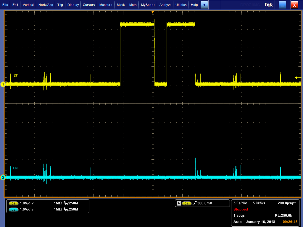

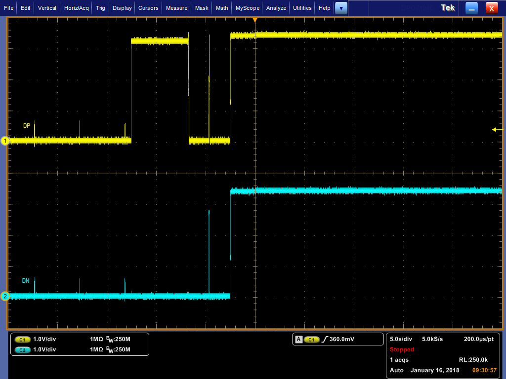

    Here is the USB D+/D- signals for reference.
    from S0 to S3, D+ and D- waveform. (this is the normal case, the hub do not has the Sandisk. so it will not auto wake up)
    auto wake up from S3 to S0, D+ and D- waveform

  • Hi SHH,
    I apologize for the delay. Does the system wake itself right after the SanDisk64G & mouse are connected?
    I'm looking into how the TPS2546 reacts to a Hub. I believe it has to do with how the TPS2546 treats the Hub. It may always want to be in S0 when a Hub is connected.
