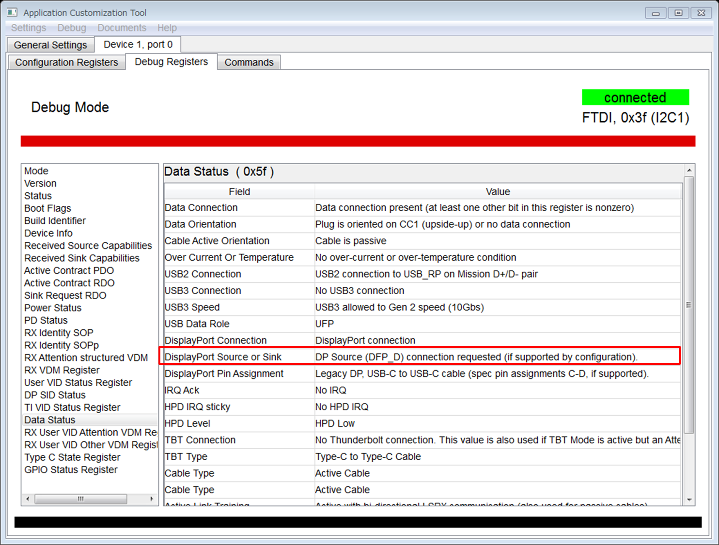

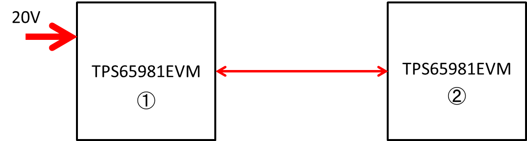

Could you tell me how DPSourceSink bit behaves?

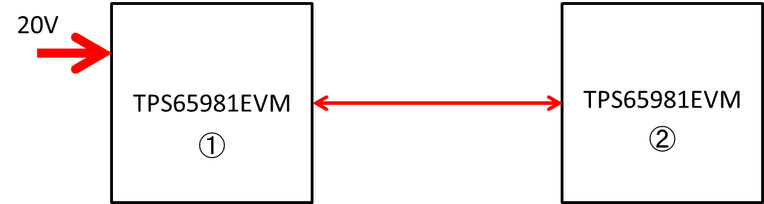

I checked DPSourceSink bit behavior using TPS65981EVM with following condition. But the bit always shows 0b "DP Source (DFP_D) connection requested" on both DFP_D and UFP_D sides. Is this bug?
① TPS65981_HD3SS460_DRP_Source_Advanced_v3_10.tpl
②   TPS65981_HD3SS460_DRP_Host_Advanced_v3_10.tpl
[① Side]
[② side]
My customer is expecting that EC can judge PD controller is in UFP_D Assignments E condition by the table below. But it is not realizable because DPSourceSink is always 0b.

  • Hi Takashi,
    Instead of using the DRP template, could you try setting on of the EVM boards as a DFP and the other as a UFP. This might fix the issue.
    ①  TPS65981_HD3SS460_DFP_Advanced_v3_10.tpl
    ②   TPS65981_HD3SS460_UFP_Advanced_v3_10.tpl

  • Hi Aramis-san,
    I checked DPSourceSink bit using DFP andUFP only FWs but It was not workaround.
    DPSourceSink bit has still showed 0b and I haven't seen any differences between DFP FW.
    If the PD controller is running as a UFP, Which value should be observed on this register, 0b or 1b?
    The explanation on Host interface Guide is very unclear.
    DPSourceSink[0x5F, bit9]
    0b DP Source (DFP_D) connection requested (if supported by configuration).
    1b DP Sink (UFP_D) connection requested (if supported by configuration).

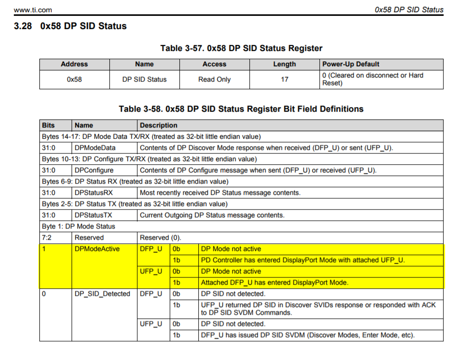

  • Hi Takashi-san,
    Could take a look at the DP SID status register (0x58)? This register will tell the user if the PD Controller has entered DisplayPort Mode with attached UFP, DFP, or none.

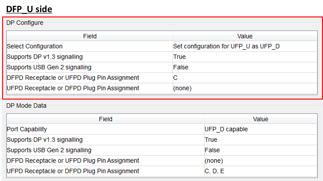

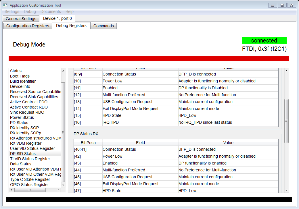

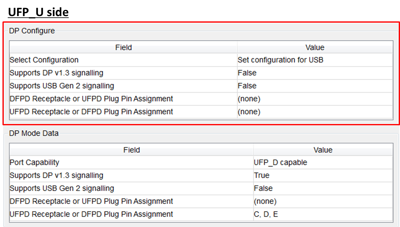

  • Hi Aramis-san,
    I'm asking about DFP_D and UFP_D, not _U. And my customer wants to know the device is running as UFP_D or DFP_D in DP alt mode.
    As far as I checked the DP SID Status(0x58) register, it seemed that "DP configure" information is not updated on UFP_U side after DP enter mode.
    Is not this the cause of ”DPSource or Sink” bit not working properly?

  • Hi Aramis-san,
    I don't think DFP_D is essentially DFP_U.
    DFP_U must behave as "Initiator" at alt mode PD communication, so that's very important role but, DFP_U and  UFP_U may support a DFP_D, a UFP_D, or both a DFP_D and UFP_D depending on its DP capability, right?
    Although I read the standard("VESA DisplayPort Alt Mode on USB Type-C Standard") easily, the item of DP configure may not be displayed normally depending on the contents of communication. I re-checked DP status table as below, PD controller role may be confirmed from this.
    But, I didn't see any change on 0x5F, DPsource or sink bit as I mentioned before. I'll waiting your update on this.
    >Question: Is the PD controller with display port working properly (not looking at the debug tool)? Are you able to use >display port on a monitor with your current configuration?
    Yes, I can display my PC's DP output to a monitor through EVM's connected with Type-C cable. So, I believe that it's working well. But on the App configue tool,  I could not see which DP role is chosen on each EVMs as the picture above.

  • Hi Takashi-san,
    I talked to the FW team and this is a bug in our GUI. The GUI will always display a 0b for the DPSourceSink register (bit 9). I filed a ticket for our FW team to fix. Thank you for catching this bug.
    Also, If this answers your question, PLEASE select  This resolved my issue.
