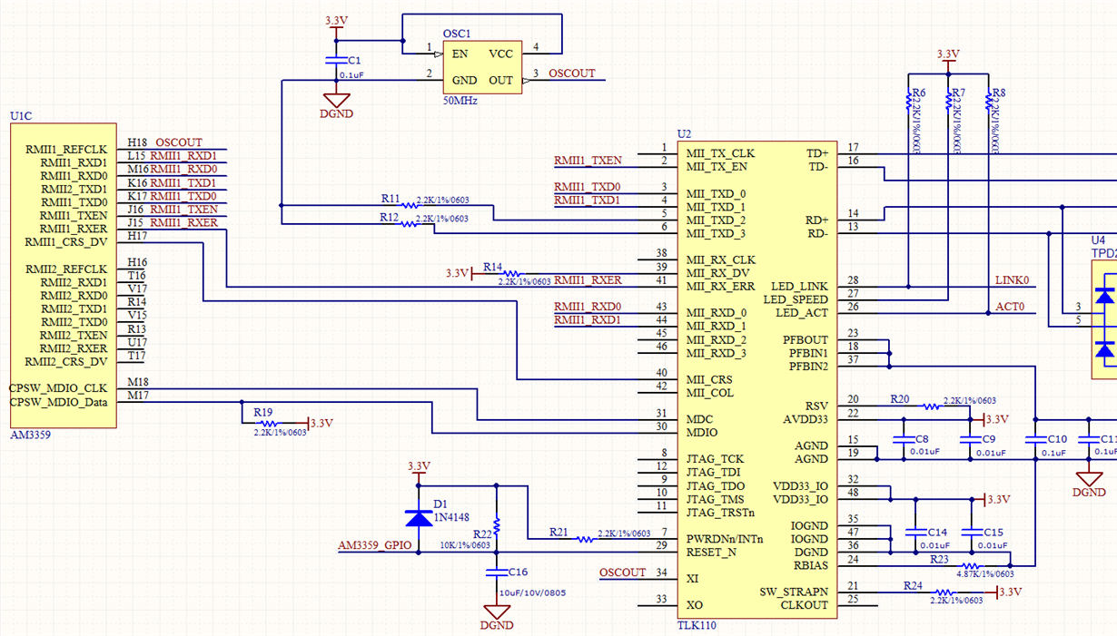

    Our schematic of TLK110 is as below:
    Thank you.
    Abby
  • Hi Abby,
    The schematic looks OK.
    What is the behavior of the PHY's registers when your communication hangs? What is the status of the LED_ACT? Does the PHY still show activity?
    Can you provide a dump of register values from 0x0 to 0x1f during normal operation? Also provide a dump of register values 0x0 to 0x1f when the communication hangs.
