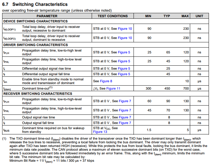

My customer asked us about tPLH for SN65HVDA1040A-Q1.
The result of tPLH was different under the following conditions A and B.
A: When the bus first transitions to dominant after continuing recessive more than 20 μs
B: When transitioning from recessive to dominant after A
A result is about 20 nsec longer than B.
Do you know the possible causes of this phenomenon?
Please let us know what you think about this phenomenon.
