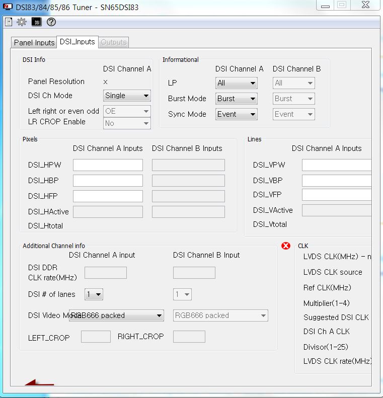

Hello.
Test condition.
LCD : 800*480
using mipi 2lane, 24BPP
LVDS clock is defined by panel as 30MHz.
DSI clock is 180MHz.
CPU : MSM8974
MSM8974 MIPI <-> SN65DSI83Q1-EVM
DSI Channel A <-> LVDS Channel B <-> LCD Panel
SN65DSI83 register control does not change the screen. and LVDS data & clock is not output.
Could you check a code please. what is wrong?
