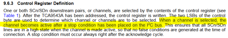

Hey Piotr,
The datasheet does not explicitly state this data, I suspect this is not a common problem and the delay time is short enough due to a guaranteed by design kind of situation. I realize this kind of answer doesn't actually give you an answer but I can give you atleast a range of what should be the max values here.....
This device will not actually enable switches until it receives a stop condition by the master:
This device was also made to follow I2C timing requirements and so if we consider the amount of time is allowed between a stop and a start condition we can atleast narrow down this range to an acceptable level.
The buffer time here states a minimum of 4.7us and 1.3us are required between a stop and start condition on the I2C bus for 100kHz and 400kHz respectively. Therefore the switch times need to be below this value in order to meet I2C standard and for the channels to be ready to communicate once the start condition begins......
