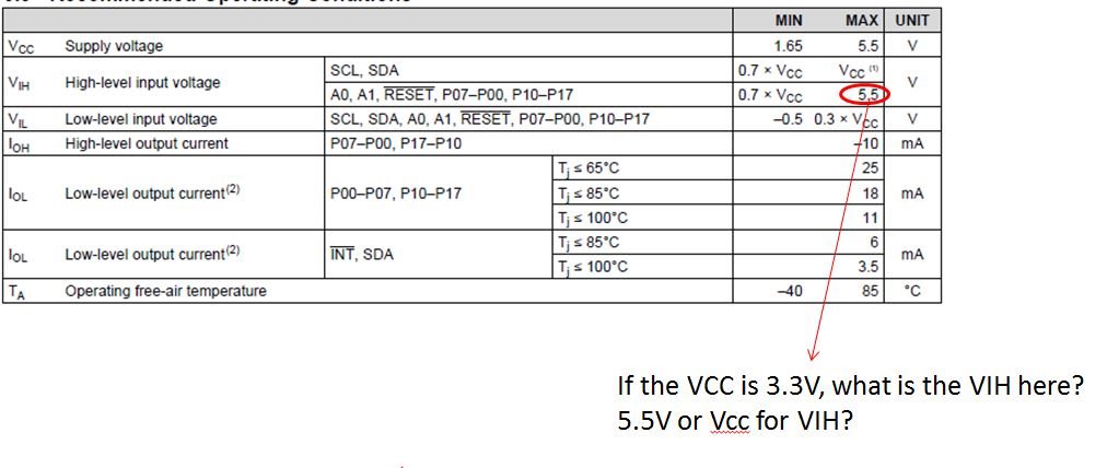

Customer would like to use two TCA9539 on the project.
Please help for the three questions.
1. one of TCA9539 VCC is 1.8V. However, cusomter measure the voltage test point TP4588 which connect to P06 pin10.
TP4588 voltage is 3.8V. does that make sense the I/O port's voltage is higher than VCC 1.8V?
2. the second TCA9539(U4501), several GPIO connect to TXB0108 for 3.3V to 5V level shift.
Could you please review the schematic is ok or not?
3. for the user case VCC is 1.8V, according to the spec, the max VIH is 5.5V for the P07-P00. Is that right? or the max should be VCC instead?
