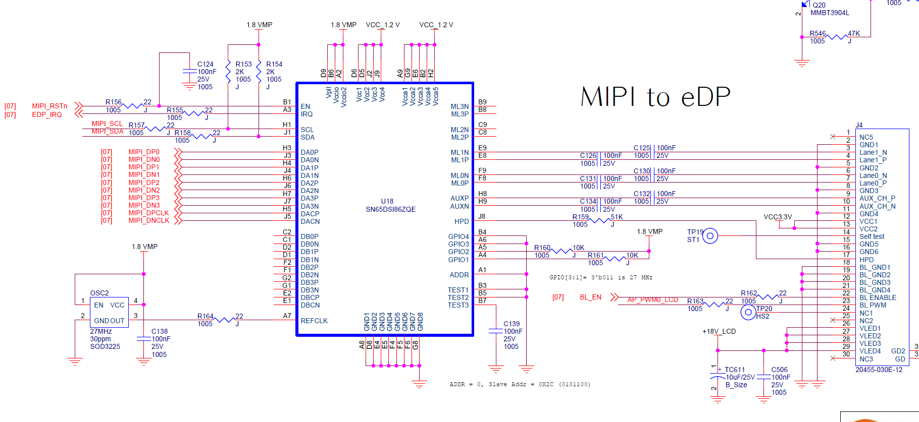

Dear TI Team.
I am designing SN65DSI86. We would like to get a review of the circuit and Register settings to identify the problem.
- Video format : RGB4:4:4
- APU/GPU maximum DSI Clock frequency is 1GHz
- Using the eDP panel
- SN65DSI86 Normal operation when Test pattern is executed.
- Screen is not displayed when Mipi signal is applied
Register dump
00 | 36 38 49 53 44 20 20 20 02 00 86 00 00 01 00 00
10 | 20 00 41 00 00 00 00 00 00 00 00 00 00 00 00 00
20 | 80 07 00 00 38 04 00 00 00 00 00 00 20 00 00 00
30 | 05 80 00 00 50 00 17 00 30 00 03 00 00 00 00 00
40 | 01 00 00 00 80 00 20 08 57 04 70 00 1c 00 20 00
50 | 05 80 80 07 38 04 00 00 40 e4 0d 01 10 00 30 00
60 | a0 60 a4 00 00 01 00 00 00 00 00 00 00 00 00 00
70 | 00 00 00 00 00 01 02 01 80 81 00 00 00 00 00 00
80 | 00 00 00 00 00 00 00 00 00 1f 7c f0 c1 07 1f 7c
90 | f0 c1 07 24 81 00 01 04 01 00 00 00 00 00 00 00
a0 | 01 ff ff 00 00 00 00 00 00 00 00 00 00 00 00 00
b0 | 04 78 ac ac 08 6c 9c 9c 0c 5c 5c 5c 0c 0c 0c 0c
c0 | 3f 3f 0f 00 00 00 00 00 00 00 00 00 00 00 00 00
d0 | 00 00 00 00 00 00 00 00 00 00 00 00 00 00 00 00
e0 | 00 00 00 00 00 00 00 00 00 00 00 00 00 00 00 00
f0 | 00 80 00 00 01 02 00 00 01 00 00 00 00 00 00 00
I would like to check the register setting and circuit diagram.
