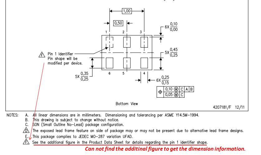

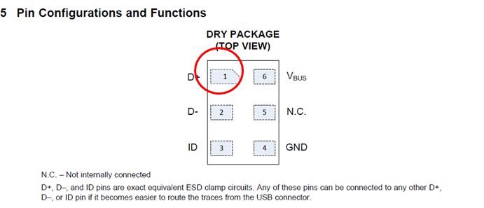

My customer needs to know the dimension of pin 1 of the TPD4S012DRYR.
The datasheet mentioned “Pin 1 Identifier, Pin shape will be modified per device”, but there is no detailed information for actual shape/dimension of the pin 1.
Could you please give me those information?
