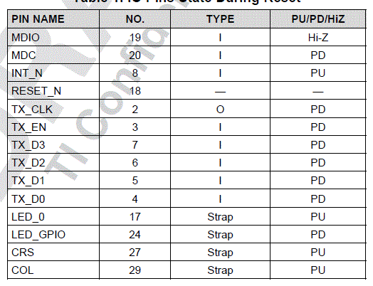

Whether internal pull-up / pull-down will be active, when reset is asserted?

Hi Rob Rodrigues
Thanks for your reply.
Whether above table is available in any application note through ti.com?

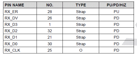

From the above table, I am seeing few pins (RX_CLK, MDC, INT_N) are having internal PU/PD which were not mentioned in datasheet, whether these PU/PD available after Reset is de-asserted also?
I think, there is typo RX_D1 --> 31 not 21.
