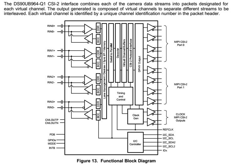

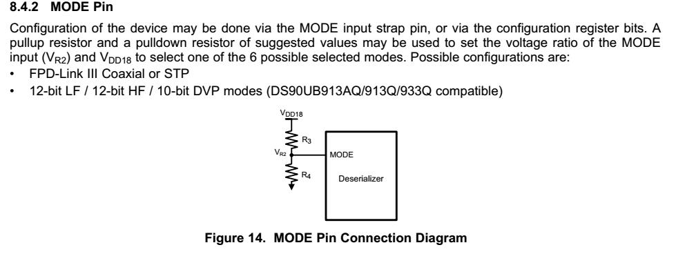

  • Dear Steven&Team,
    I choosed a image sensor with 960p resolution,12 bits per pixel,60 fps. So the max output data rate would be OK for DS90UB964-Q1's bandwidth.
    But in the datasheet of 964, it only supports three modes. Their are 12-bit LF/12-bit HF/10-bit DVP mode(DS90UB913AQ/913Q/933Q compatible) .
    And in the functional block diagram of 964, it has a block named 'Serial to Parallel', it is very different from 954.
    Therefore, I guess that 964 can not deserialize the CSI-2 protocol serial data from 953, but I am not sure that.
    Please help to confirm this issue. Has anyone ever done that before?
    Thanks.
