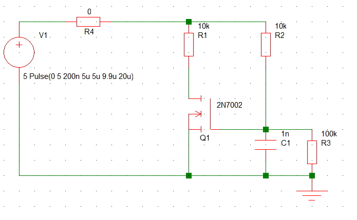

    The reason I am asking is that am using the nmosfet circuit you suggested. I did a SPICE simulation and got good results i.e.
    However then I realised that I might need an additional capacitor on the VBUS_POWER (in accordance with the data sheet as you mentioned -  0.1uF and 4.7uF) -
    1. Is this required in addition to the C1 I have ?
    2. I realised that my results were very dependant on the rise time of the VBUS_POWER - thus I was wondering what value I should put into the simulator  ?
    Bets regards
    Shmuel

  • Chuck,
    The 0 Ohm resistor was only a fake so that I could get a good current reading.
    When I added the capacitor on the VBUS_Power the current drawn was very high until I realised that it was dependant on the rise time of the VBUS_Power. If I place a 1uF Cap what scale of rise tiem do you think I will get ?
  • Shmuel,
    With this type of circuit is is a little difficult to estimate because I don't have data on how the regulator will perform. It will charge somewhat like a resistor while the voltage is rising because the LDO will not be in compliance initially, then will start regulating once the capacitor is charged and the current reduces.
    I did take a look at figure 6 in the spec, and if your system uses the recommended capacitor values, it is a good assumption the VBUS_POWER will track the VBUS_CONN rise time very well, so you can use the VBUS_CONN rise times for your simulation.

  • Dear Chuck,
    I looked around and found the max rise time for VBUS is 100mS. I actually went and took my own measurements and found that its rise time was approx 10mS on the specific computer I used. The problem is I have to deal with 2 extreme scenarios :-
    1. A cold start up - VBUS rise approx 10mS - 50mS (when my device is plugged into a computer \ USB power supply that is not powered and then the power is turned on )
    2. When my device is plugged into a usb port that is already powered (VBUS already present at full voltage) - thus the rise time on my VBUS could be 20nS - 50uS
    Best regards
    Shmuel
  • Shmuel,
    I agree with your calculations. The circuit I gave you should be very robust to situation #2 with a fast rise time. The design challenge will will be to size the resistive divider for the gate fet and the capacitor size to meet the 50ms rise time case.
    Chuck
  • Dear Chuck,
    So I now assuming that the min rise time of the VBUS_Power will be 10uS with the recommended 1uS on VBUS_CON and 0.1uS(min) on VBUS_CON. However according to my SPICE simulation this causes a very short spike in current the width of rise time well above the 3mA limit.
    Please advise ?
    Best regards
    Shmuel
  • Shmuel,
    Can you give me the waveforms and the schematic of your spice simulation?
    Chuck
  • Chuck,
    No problems - below is the schematic
    Here is the simulation :-
    and the zoomed in to see the current
    Best regards
    Shmuel
  • Shmuel,
    There is no limiting resistance connected to the C2 capacitor, so you will see high currents as that capacitor charges and discharges in your spice simulation. The 100k resistors will prevent the other legs from drawing current, but the 100nF capacitor will have to charge. Most USB circuits have 1uF to 10uF out load cap on the VBUS rail, so this capacitor should be within the expected current draw of the system.
    The 3mA is typically looked at as a steady state current after the device has been plugged in , but before it is enumerated.
    Chuck
  • Dear Chuck,
    Do you think I need to put a resistor in series with C2 to limit this current spike ?
    Shmuel
  • Shmuel,
    I do not think that the resistor is necessary. The circuit meets the spirit of the USB specification and should not cause on compliance issues.
    Chuck
