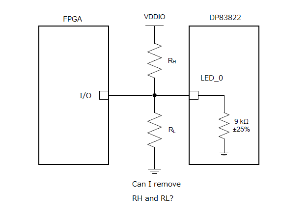

Dear Specialists,
My customer is considering DP83822.
He'd like to confirm how to use LED_0.
I would be grateful if you could advise.
Could you please confirm my understanding.
(1)LED_0 has an internal pull-down resistor only, there is not pull-down resistor.
(2)LED_0 can connect to logic device like FPGA.
In this case, I think it doesn't require pull-up or pull-down resistor.
Because LED_0 isn't for LED lighting.
Is this correct?

  • Hi Shinichi,
    The LED_0 pin should have an external pull-down at all times.
    yes, it can.

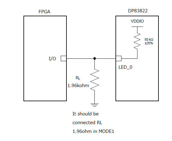

  • Hi Rob,
    Thank for your reply.
    I'd like to organize your comments.
    question (1) and (2)
    When the customer use Mode1 and connect to FPGA I/O, the connection is listed below.
    Is it correct?
    Previous mail I wrote LED_0 is pull-down, but pull-up is correct.
    (3) I understand if CRS pin is set to mode2 or 3, LED_1 indicates speed of link.
    In this case, Which address does LED_SPEED correspond to?
    (4) I understand.
    Also polarity is able to change  by LED_0 Polartity of LEDCR bit7(TAble 38.)
    Is it correct?
    I appreiciate your great help and cooperation.
    Shinichi

  • Hi Shinichi,
    For mode 1 on LED_0, the strap that you have shown is correct. I would also recommend to check if FPGA has internal pull resistors and what is the behavior of that IO pin during power up.
    CRS pin will control the functionality of of LED_1. This is reflected in register 0x460 bit [11:8].
    Yes, LED_0 polarity can be changed from register 0x18 bit 7.
