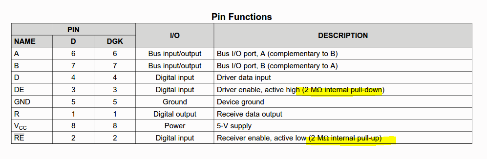

Hello.
I saw THVD1550 SPEC description "2 MΩ internal pull-down / UP" on DE and RE pin. Is it new function of THVD1550 ?
May I know why such a design increase. Thanks~
AJ,
The pull down and pull up circuitry were there in some other RS485 transceivers, like HVD78, HVD82. The value is specified in THVD1505 to help some customer to design their digital interface. Please let me know if you have other questions.
AJ,
For example, if you want to change default state by adding external pull up or pull down resistors at the pin, you would know how much resistance you need to override the internal one. Some customers asked such information before. Please let me know if you have more questions.
