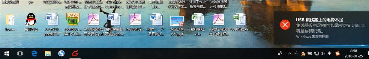

Use TUSB2046B to do a USB hub, Computer desktop: the power supply on the USB hub is insufficient. The hub does not have enough power to support USB large capacity storage devices.

    The USB 2.0 specification defines a maximum current draw of 500mA from Vbus. If the TUSB2046B is configured as a bus-powered hub, 500 mA may not be enough to power-up both a large capacity HDD and the TUSB2046 along with all the other components on your hub implementation.
    If you are willing to support large capacity hard drives on your hub application, I would recommend to switch to a self-powered implementation and to make sure the the power supply sourcing the downstream ports can support the intended load.
