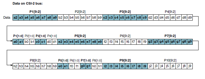

Our customer will use 954 as RAW10 mode connected 913A.
Please tell me the correlation between the YUV input data of 913A and the data array of the output in RAW10 mode of 954.

I do not know what value should be set for 0x70[5:0].
Is data array specified by the data protocol of MIPI CSI-2?
I have not been able to see the CSI-2 specification document.

Finally please check whether the following recognition is correct.
I recognize that the RAW10 data output format of CSI-2 is as shown in the above figure.
At this time, the parallel input of 913A DIN [9] of the first PCLK corresponds to a9 of the first byte of CSI output in the above figure.
Then, DIN[0] of the first PCLK corresponds to a0 of the fifth byte.
Thereafter, DIN[9:0] of the second PCLK clock corresponds to b9 to b0 of the CSI output.
Is it correct recognition?
