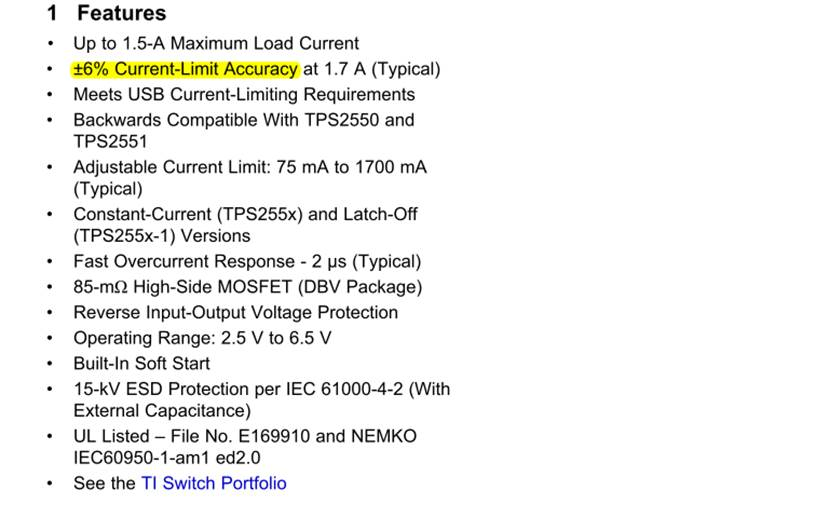

Part Number: TPS2553
Customer current limit set to 900mA. What is current limit accuracy on 900mA ? Is it still +-6%? Thank you.
BR
Patrick
