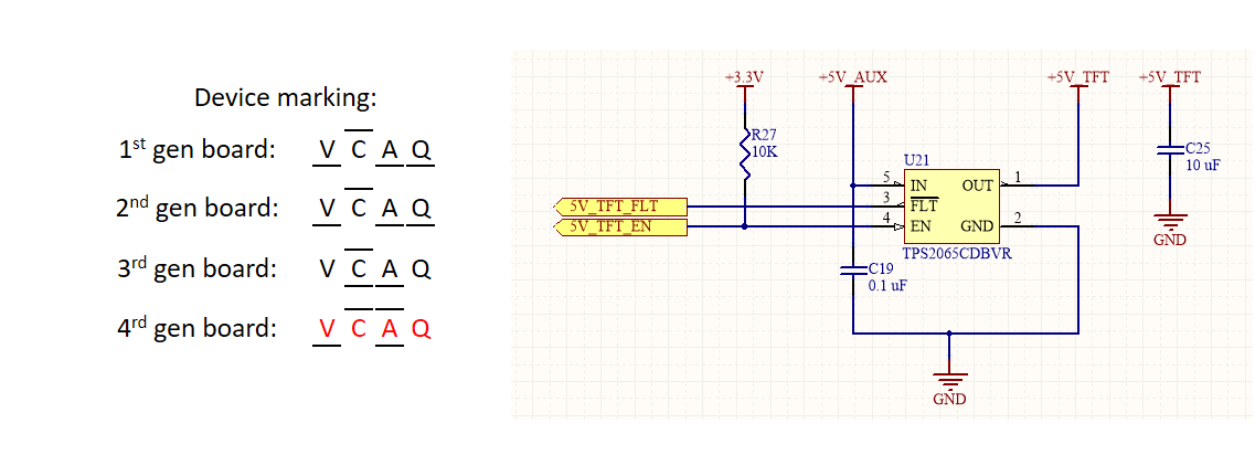

Consider 2 identical non-isolated (common ground) dcdc converter (say C1 and C2), and 2 TPS2065C groups (say A and B). Vin of A and B are C1 and C2 respectively. The A group is enabled by C1 as usual, but may I enable B with C1 as well? Indeed, in one of our prototypes, I’m burning out all B and no A parts. Can this be the cause? BTW, I have done this before without any problem until now.

    First some background of our design. Few years ago, we developed a base board (or motherboard) for one of our project which includes 2 dcdc converter 12/5 VDC and up to 5 switches (last release). The current release of the board is the 4th generation, which experienced the – burned out – switches (more precisely 3 of 5 switches are burned out, we guess, by our application, no standalone test was performed). We never experienced problems with switches before.
    For device marking and schematic of one switch, please see attachment (in red device marking which burned out). Output load are passive (no source is connected to the output), FLT and EN signal are handled by the micro controller @ 3.3 V; DCDC converter are a Murata 12/5 VDC, 1.5 A max current output.

  • Hi Wolf,
    Sorry for reply late! As you mention you have do the comparision test between Gen3 and Gen4 and found the Gen4 power swith more hot than Gen3. Do you have thermal test result for analysis?
    I suggest you use the Gen 3 sample to replace Gen4 to double confirm it is not the PCB board and external component issue(PCB Cu thick will impact heat dissipation ).
