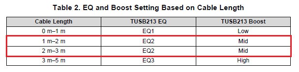

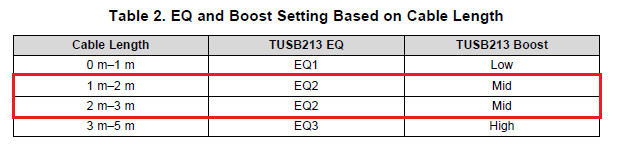

I saw the user guide of TUSB213 Evaluation Module and confused the EQ and Boost Setting on document.
There used same setting value on long cable for 1~2m and 2~3m, is it correct?
Henry.
  • Hi Henry,
    That is correct, since the adjustment should be enough to compensate the loss. but please notice that the table is an example and guideline to compensate the cable loss and the customer must perform an electrical test in order to find the right settings for the implementation, this is mainly because each cable/Boards varies on its loss profile, also the USB interfaces (Host or device) may have different TX and RX characteristics which have to be taken into account.
    Diego.
