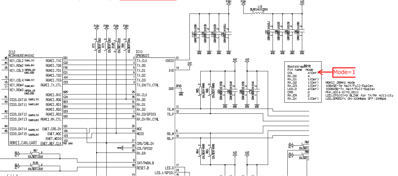

I made a board using DP83822I.
I will attach some excerpts of the board drawing.
In setting Bootstrap, I intend to set the COLpin to "MODE=1".
However, the recommended setting method is to pull down with 1.96kΩ.
I want to ask you a question.
Is there a problem connecting the COLpin directly to GND?
In this case, will it function according to the setting of "MODE=1"?
