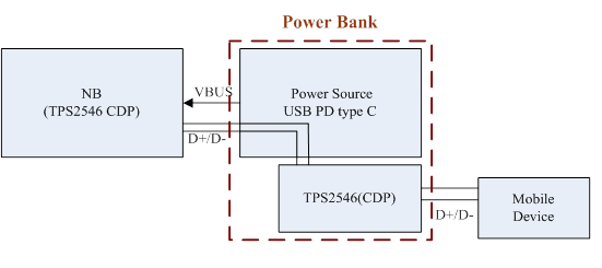

Customer encounter a question that they are making a power bank for a NB brand that charges the NB
for the power bank to charge the NB the TPS2546 will be in CDP mode.
however, it's found that the NB type C setting also has a TPS2546 that's configured as CDP mode
can you help on a couple of questions
1. CDP+CDP would it cause any communication issue? is found the NB wouldn't recognize the mobile device (50% of the chance)
2. when NB is getting charged, should the NB not be CDP mode anymore? since it's not a charging port
Thanks very much for the help

    1.  The laptop is charging the power bank here and then a phone is connected to the power bank for data communication to the NB and charging from the power bank?
    JC: the power bank is charging TO the NB, and also charging to the cell phone, just by pass the D+D- pin from cell phone to NB
    2.  The notebook has a Type-C port correct? When the NB is being charged, it should depend on the Type-C connection only as the TPS2546 is meant to act as a source not a sink.  I'm assuming the TPS2546 is used with the Type-C port just in-case a Type-C to Type-A cable is connected.  Therefore it may be better to have the TPS2546 in SDP when charging the NB as the NB shouldn't be charging anything from the same port as it is being charged from anyway.
    JC: yes note book as a type C port and getting charged by the power bank. so it's expected in this connection that the NB should be in SDP mode when GETTING charged right?

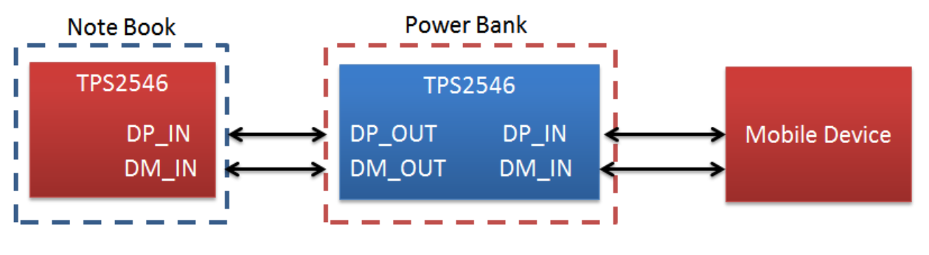

  • Hi John,
    There shouldn't be any issue with the TPS2546s both in CDP as long as they are connected as shown below.
    I tried this in the lab with two EVMs connected as shown and my phone which does BC1.2 charging charged correctly and was recognized by the computer.
    The Vbus of the two devices are not connected right?  I'm guessing the Type-C controller in the notebook has it's own Vbus path and the notebook's TPS2546's Vbus is left open.
    Donovan
