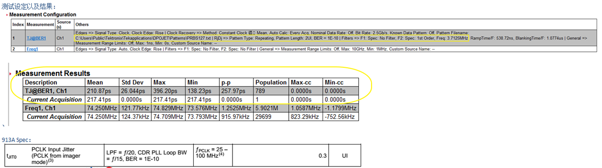

Can you help to check if the setting of Jitter test of DS90UB913A is Okay or not?
LPF(3.7125M)+BER=1E-10.
