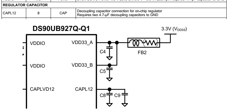

[ DS90UB927 & DS90UB928 ] Two Capacitors for CAPL12
My customer has noticed that their board has only one 4.7uF for CAPL12 pin while datasheet suggest to have two.
Does this cause any of potential failures?
Also, if different values such as smaller or larger caps than 4.7uF are used, what kind of issue can be occurred?
