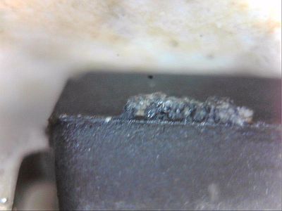

Part TPD4E1B06 is used to protect a PTH hand soldered connector and is in close proximity to it. After the hand soldering with a no clean solder the PTH pads are brushed as recommended by the solder supplier,
After running the unit we are seeing some chemical effect at  the device at the join between the two half's of the plastic package at each end, and the part goes leaky. Once this problem has occurred the fault stays with the part but is intermittent and pressing on the package can trigger it.
It appears to be to do with the flux which seems to get brushed over the part.
No other SMD parts near by show the same issue. I have pictures of the effect which seem to follow the package join line. Is there something about this package that makes it more susceptible, the package join on some parts looks like it has small holes allowing the flux entry?
We have to retrieve a large number of products from the field and remove these devices. We will shortly be starting new manufacture and wondered whether we should be using different parts.

  • Yes, it is the same issue but I have now managed to narrow down the problem and boards have been manufactured 6 months, I have attached pictures, a working chip, and three  pictures of a problem chip, in-situ and removed from the board.
    Hand solder is Qualitek NC601 LEAD FREE NO CLEAN SOLDER WIRE (Data sheet https://www.qualitek.com/nc601_snagcu_tds.pdf )
    SMD paste is BLT LFS-UFP-T4 (Data sheet http://bltcircuitservices.co.uk/wp-content/uploads/2017/06/LFS-UFP-T4.pdf )

  • Stephen,
    From the pictures, we are not able to see any damage. The zoom in areas you seem to be referring to are a normal phenomena of the assembly mold process, and not necessarily indicative of any damage. There should not be any intrusion path here. Also, you indicate that you suspect interaction from the solder flux, but I'm not sure why there would be any solder flux on this part of the chip. However it is possible that the chemicals from a no clean solder flux will not fully evaporate and leave acidic residue if not used properly.
    To be sure the exact cause of leakage on these parts, can you submit a "Quality, Reliability and Environmental" issue at http://www.ti.com/supportform ?
    We will continue investigation of your issue there.
