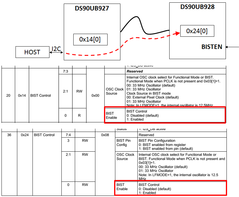

Can you help me to address few BIST related queries from my customer?
See the drawing below.
<Q1: BIST Enable/Disable through resistor>:
According to the datasheet, the BIST mode can be controlled through BISTEN pin or BIST control register of deserializer.
However, we still have similar resistor in serielizer, this case DS90UB927-Q1.
Can this resistor of DS90UB927-Q1 do the same function with DS90UB928=q1's?
<Q2 I2C communiaction during BIST>:
Is it possible to use I2C communication for local devices (HOST - UB927) and between remote devices (HOST - UB928 via UB927)?
If this can work, the BIST can be controlled from HOST sitting on serializer through I2C remote access.
