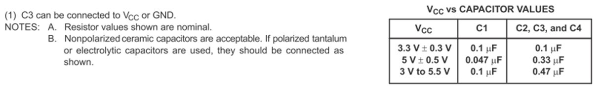

Hi Team,
About Pin27(V+), data sheet suggests through a cap connect to GND or VCC.
So could it directly connect to VCC?
What is the side effect if we use this kind of connection?
  • Daniel,
    V+ is charge pump output therefore it needs a cap to a DC bias, GND or VCC. If it's shorted to VCC, the output voltage won't be able to be charged higher than VCC.
    Please let me know if you have any other questions.
