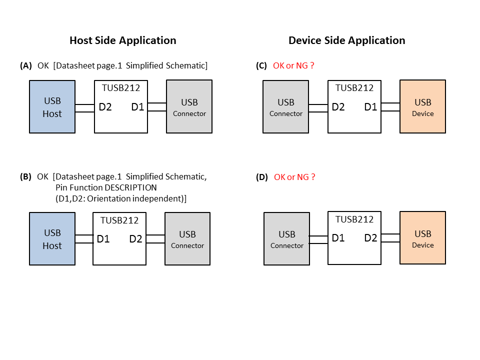

Hi team,
My customer wants to know whether TUSB211 can be used for device side application.
I think TUSB211 can be used for device side application.
Please see the figure below. I think TUSB211 can be used as placement (C) and (D).
Is this correct? Please let me know.
