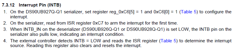

I understood INTB pin outputs LOW when INTB_IN on deserializer is set LOW as the following.
Can INTB pin still output LOW if deserializer loses lock during interrupt condition?
