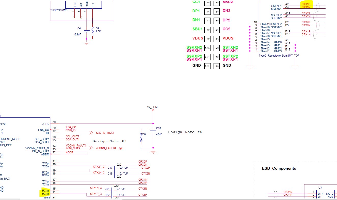

I got HD3SS3220 DFP reference schematic as below but I have one question why RX1P/ RX1N connect to Type C SSTXP1/ SSTXN1.
If need to modify the schematic RX1P to SSRXP1 & RX1N to SSRXN1?
Please kindly help to confirm again.
