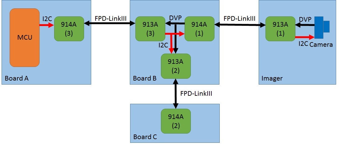

Our customer is planning the following structure.
(The red line is I2C bus)
Can the MCU access to 913A(1) and 914A(2) ?
I think that the MCU can access to 914A(3) and 913A(3) and 913A(2) and 914A(1).
Could you tell me?
