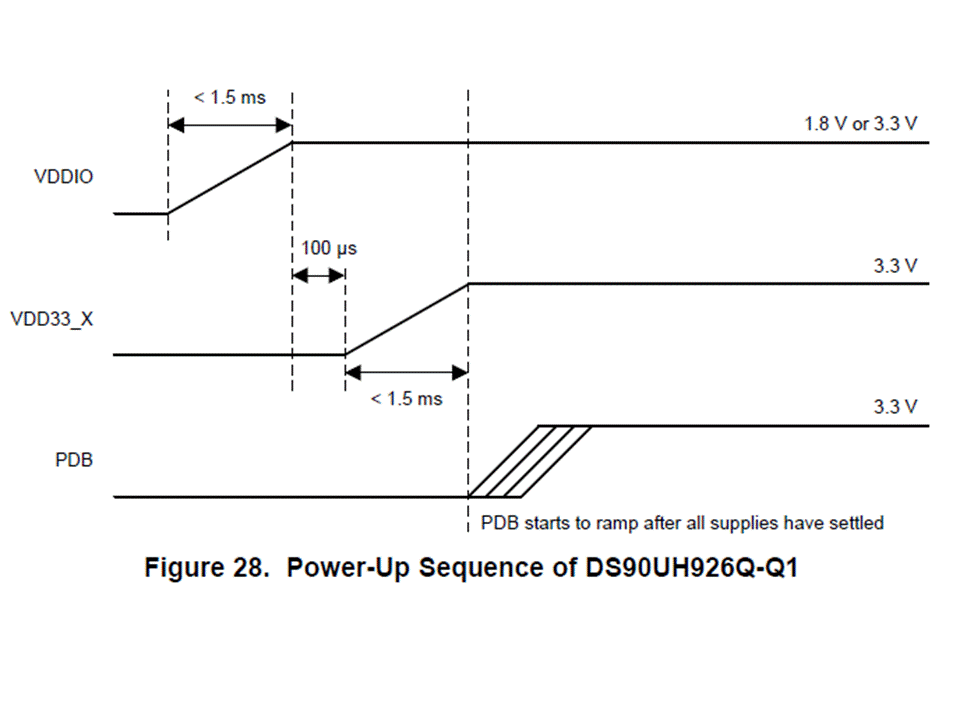

Hi team,
My customer wants to know whether DS90UH925Q-Q1 has the same power-up sequence as
DS90UH926Q-Q1 regarding VDDIO and VDD33.
I could't find power-up sequence description regarding VDDIO and VDD33 in the DS90UH925Q-Q1 datasheet.
But, please let me know.
